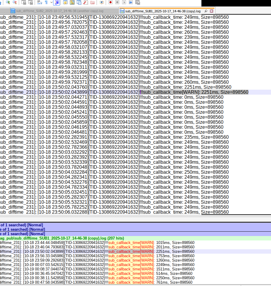

问题：遇到两次回调间隔概率性出现超过250ms，达到1s甚至2s；如下面日志图片</p>
<p dir="auto"><img src="/forum/assets/uploads/files/1760943021404-0a992584-d048-485e-b195-0cc4d6a47878-image.png" alt="0a992584-d048-485e-b195-0cc4d6a47878-image.png" class=" img-fluid img-markdown" /></p>
<p dir="auto">现象：从日志图片看，进入回调间隔2251ms后，后续马上0ms间隔处理完队列中对接的数据。</p>

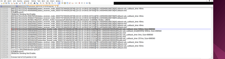

1） 日志中在10-22 14:39:02.549559时间出现问题<br />
[INFO] [1761115142.558019205] [subscriber_thread_node_9303776749428128748]: [10-22 14:39:02.549559][TID-140593497855552]!!!sub1 sub_callback_time: 509ms, Size=898560<br />
<img src="/forum/assets/uploads/files/1761219765441-screenshot-from-2025-10-22-15-00-48-resized.png" alt="Screenshot from 2025-10-22 15-00-48.png" class=" img-fluid img-markdown" /><br />

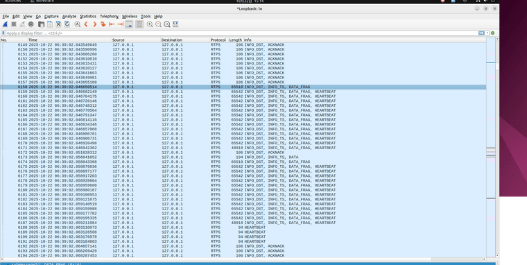

2）wireshark抓包发现，在2025-10-22 06:39:02.557394522 连续收到2个包；（小时为06,是wireshark显示异常，分钟和秒是对应上的）<br />
2025-10-22 06:39:02.571319420收到的是另一个主题sub6的数据<br />
<img src="/forum/assets/uploads/files/1761220015217-screenshot-from-2025-10-22-15-07-49-resized.png" alt="Screenshot from 2025-10-22 15-07-49.png" class=" img-fluid img-markdown" /><br />

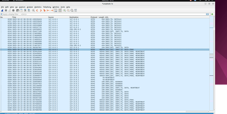

3）为了证实确实少发了，通过wireshark查看上一个250ms的时间点2025-10-22 06:39:02.323376345<br />
只有一次数据发送<br />
<img src="/forum/assets/uploads/files/1761220056415-screenshot-from-2025-10-22-15-12-51-resized.png" alt="Screenshot from 2025-10-22 15-12-51.png" class=" img-fluid img-markdown" /><br />

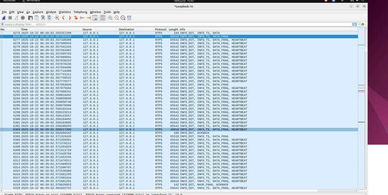

4）再通过wireshark查看上上个250ms的时间点2025-10-22 06:39:02.046650514 和 2025-10-22 06:39:02.058843368 ，在12ms收到了2帧数据(sub1和sub6)<br />
<img src="/forum/assets/uploads/files/1761220107175-screenshot-from-2025-10-22-15-14-33-resized.png" alt="Screenshot from 2025-10-22 15-14-33.png" class=" img-fluid img-markdown" /></p>

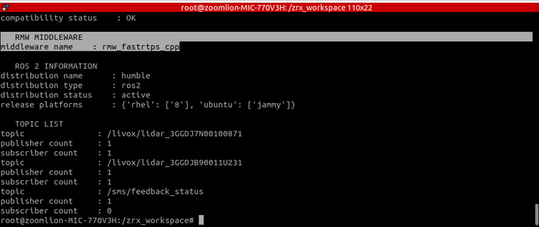

<strong>中间件</strong>：默认的 fastdds (如图)<br />
<strong>数据大小</strong>：898560Byte，大概877.5KB，点云数据。<br />
<img src="/forum/assets/uploads/files/1761045471355-da7dd2c1-24e4-4408-af58-9d1673f0b569-image-resized.png" alt="da7dd2c1-24e4-4408-af58-9d1673f0b569-image.png" class=" img-fluid img-markdown" /></p>
