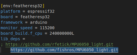

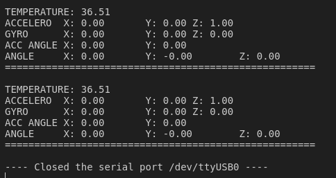

]]></description><link>https://fishros.org.cn/forum/topic/4613/mpu6050初始化失败</link><generator>RSS for Node</generator><lastBuildDate>Thu, 27 Aug 2026 01:13:19 GMT</lastBuildDate><atom:link href="https://fishros.org.cn/forum/topic/4613.rss" rel="self" type="application/rss+xml"/><pubDate>Tue, 28 Oct 2025 09:09:25 GMT</pubDate><ttl>60</ttl><item><title><![CDATA[Reply to MPU6050初始化失败 on Wed, 05 Nov 2025 10:37:45 GMT]]></title><description><![CDATA[<p dir="auto"><a class="mention plugin-mentions-user plugin-mentions-a" href="https://fishros.org.cn/forum/uid/27056">@1223386926</a> 改为0x6A虽然不会报错，但无法读取有效的数值。根本原因在于用错了库，不应该使用https://github.com/rfetick/MPU6050_light.git，而是应该https://github.com/fishros/MPU6050_light.git。<br />
<img src="/forum/assets/uploads/files/1762339023705-e4b830da-4cdd-4262-8d7b-e2580a8303ff-image.png" alt="e4b830da-4cdd-4262-8d7b-e2580a8303ff-image.png" class=" img-fluid img-markdown" /> <img src="%E5%9B%BE%E7%89%87%E5%9C%B0%E5%9D%80" alt="替代文字" class=" img-fluid img-markdown" />。<br />

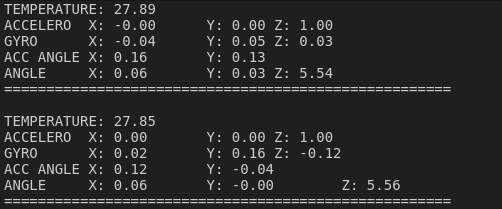

换完之后，就可以按教程中的代码读取数值：<br />
<img src="/forum/assets/uploads/files/1762339061568-872171f9-a41a-44d1-8b4c-b5293335c092-image.png" alt="872171f9-a41a-44d1-8b4c-b5293335c092-image.png" class=" img-fluid img-markdown" /></p>

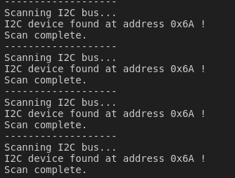

<p dir="auto"><img src="/forum/assets/uploads/files/1761741705047-2698c065-ef0b-4924-89d1-4ae4220c57ba-image.png" alt="2698c065-ef0b-4924-89d1-4ae4220c57ba-image.png" class=" img-fluid img-markdown" /></p>
