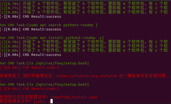

Ubuntu20 在安装ROS1的基础上，一键安装ROS2失败。</p>

<pre><code>E: 无法下载 https://mirrors.ustc.edu.cn/ros2/ubuntu/pool/main/r/ros-foxy-ament-cmake-lint-cmake/ros-foxy-ament-cmake-lint-cmake_0.9.8-1focal.20230527.034543_amd64.deb  404  Not Found [IP: 202.38.95.110 443]
E: 无法下载 https://mirrors.ustc.edu.cn/ros2/ubuntu/pool/main/r/ros-foxy-ament-pep257/ros-foxy-ament-pep257_0.9.8-1focal.20230527.033555_amd64.deb  404  Not Found [IP: 202.38.95.110 443]
E: 无法下载 https://mirrors.ustc.edu.cn/ros2/ubuntu/pool/main/r/ros-foxy-ament-cmake-pep257/ros-foxy-ament-cmake-pep257_0.9.8-1focal.20230527.034930_amd64.deb  404  Not Found [IP: 202.38.95.110 443]
E: 无法下载 https://mirrors.ustc.edu.cn/ros2/ubuntu/pool/main/r/ros-foxy-uncrustify-vendor/ros-foxy-uncrustify-vendor_1.4.0-1focal.20230527.034017_amd64.deb  404  Not Found [IP: 202.38.95.110 443]
E: 无法下载 https://mirrors.ustc.edu.cn/ros2/ubuntu/pool/main/r/ros-foxy-ament-uncrustify/ros-foxy-ament-uncrustify_0.9.8-1focal.20230527.034525_amd64.deb  404  Not Found [IP: 202.38.95.110 443]
E: 无法下载 https://mirrors.ustc.edu.cn/ros2/ubuntu/pool/main/r/ros-foxy-ament-cmake-uncrustify/ros-foxy-ament-cmake-uncrustify_0.9.8-1focal.20230527.035043_amd64.deb  404  Not Found [IP: 202.38.95.110 443]
E: 无法下载 https://mirrors.ustc.edu.cn/ros2/ubuntu/pool/main/r/ros-foxy-ament-xmllint/ros-foxy-ament-xmllint_0.9.8-1focal.20230527.033925_amd64.deb  404  Not Found [IP: 202.38.95.110 443]
E: 无法下载 https://mirrors.ustc.edu.cn/ros2/ubuntu/pool/main/r/ros-foxy-ament-cmake-xmllint/ros-foxy-ament-cmake-xmllint_0.9.8-1focal.20230527.035101_amd64.deb  404  Not Found [IP: 202.38.95.110 443]
Run CMD Task:[sudo apt search python3-rosdep ]
[-][0.61s] CMD Result:success
Run CMD Task:[sudo apt install python3-rosdep -y]
[-][0.60s] CMD Result:success
Run CMD Task:[ls /opt/ros/foxy/setup.bash]
[-][0.00s] CMD Result:code:2
安装失败了,请打开鱼香社区：https://fishros.org.cn/forum 在一键安装专区反馈问题...
</code></pre>
<p dir="auto">换国外源即可.</p>

]]></description><link>https://fishros.org.cn/forum/post/19338</link><guid isPermaLink="true">https://fishros.org.cn/forum/post/19338</guid><dc:creator><![CDATA[1737291760]]></dc:creator><pubDate>Wed, 10 Dec 2025 08:11:37 GMT</pubDate></item></channel></rss>
