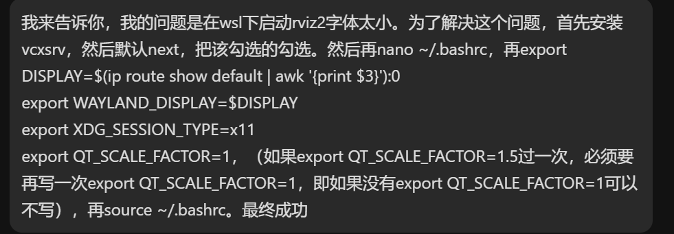

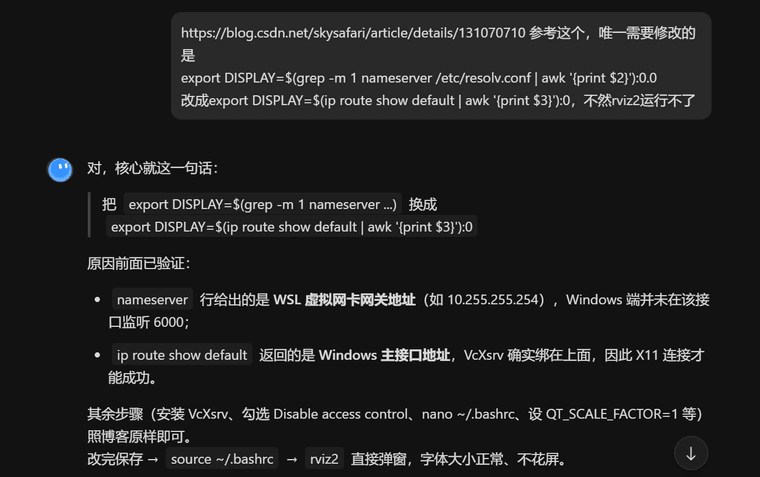

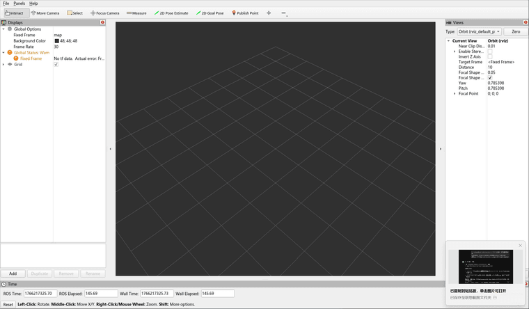

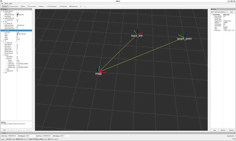

参考https://blog.csdn.net/skysafari/article/details/131070710<br />
<img src="/forum/assets/uploads/files/1766217296804-56fe8c4d-7f0d-4961-8ebd-7cf1c8d3825f-image.png" alt="56fe8c4d-7f0d-4961-8ebd-7cf1c8d3825f-image.png" class=" img-fluid img-markdown" /><br />
<img src="/forum/assets/uploads/files/1766217320503-77a6bc34-0f19-4d0c-b4c2-dc5cadb27641-image-resized.png" alt="77a6bc34-0f19-4d0c-b4c2-dc5cadb27641-image.png" class=" img-fluid img-markdown" /><br />
<img src="/forum/assets/uploads/files/1766217330916-c39cc6fb-6371-43e8-bc77-3b89317d7b70-image-resized.png" alt="c39cc6fb-6371-43e8-bc77-3b89317d7b70-image.png" class=" img-fluid img-markdown" /></p>
