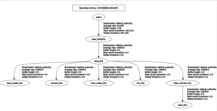

<?xml version="1.0" encoding="UTF-8"?><rss xmlns:dc="http://purl.org/dc/elements/1.1/" xmlns:content="http://purl.org/rss/1.0/modules/content/" xmlns:atom="http://www.w3.org/2005/Atom" version="2.0"><channel><title><![CDATA[视频6.4.4疑问好奇贴，rviz中的robotmodel的左右轮不显示，显示No transform from [left wheel link] to [odom]，No transform from [right wheel link] to [odom]]]></title><description><![CDATA[<p dir="auto">疑问：当tf_tree如下图显示的时候，rviz中的robotmodel的左右轮不显示，显示No transform from [left wheel link] to [odom]，No transform from [right wheel link] to [odom]<br />
<img src="/forum/assets/uploads/files/1767096110255-daa22d12-5aff-4133-a4f1-8c24eaacf80e-image-resized.png" alt="daa22d12-5aff-4133-a4f1-8c24eaacf80e-image.png" class=" img-fluid img-markdown" /></p>

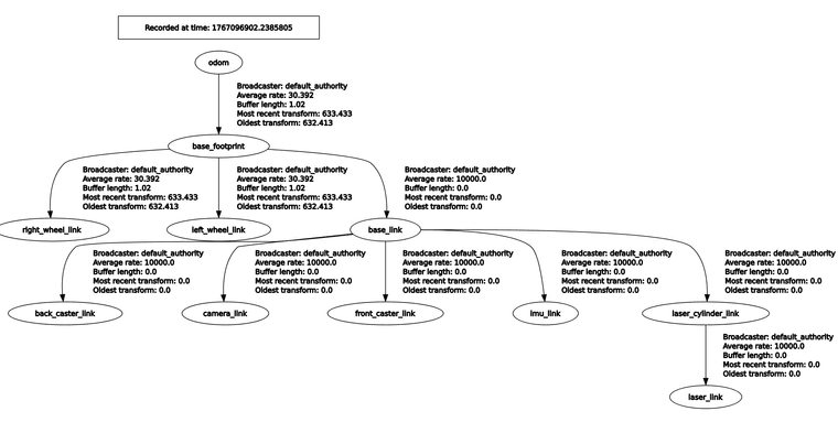

<p dir="auto">后面不知道为什么，可能是我重启的原因，tf_tree变为了<br />
<img src="/forum/assets/uploads/files/1767097306157-1867fb8d-5b09-432c-bd26-6575305b1da9-image-resized.png" alt="1867fb8d-5b09-432c-bd26-6575305b1da9-image.png" class=" img-fluid img-markdown" /></p>
<p dir="auto">这个时候rviz中的robotmodel的左右轮就正常显示了</p>

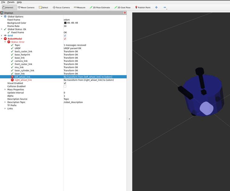

<p dir="auto">rviz2出错图：<br />
<img src="/forum/assets/uploads/files/1767095961868-fefec13a-77a7-420a-b4ea-a15c8124c0d2-image-resized.png" alt="fefec13a-77a7-420a-b4ea-a15c8124c0d2-image.png" class=" img-fluid img-markdown" /></p>

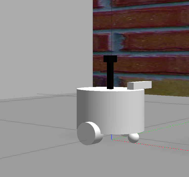

<p dir="auto">gazebo的显示没有问题<br />
<img src="/forum/assets/uploads/files/1767096028036-cf046974-d081-4a57-a15a-634df8d48d64-image.png" alt="cf046974-d081-4a57-a15a-634df8d48d64-image.png" class=" img-fluid img-markdown" /></p>
