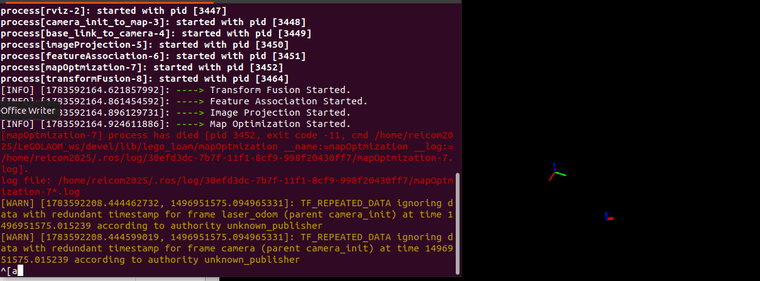

<img src="/forum/assets/uploads/files/1783592533056-586f77a928efcd65d2708193a22115c0-resized.png" alt="586f77a928efcd65d2708193a22115c0.png" class=" img-fluid img-markdown" /></p>
<p dir="auto">报错如上，具体报错如下：<br />
[mapOptmization-7] process has died [pid 3677, exit code -11, cmd /home/reicom2025/LeGOLAOM_ws/devel/lib/lego_loam/mapOptmization __name:=mapOptmization __log:=/home/reicom2025/.ros/log/32df3f74-7b80-11f1-8cf9-998f20430ff7/mapOptmization-7.log].<br />
log file: /home/reicom2025/.ros/log/32df3f74-7b80-11f1-8cf9-998f20430ff7/mapOptmization-7*.log<br />
使用AI，修改rviz,以及降低bag播放速度都不行。还是显示不了点云地图怎么解决<br />
<img src="/forum/assets/uploads/files/1783592691995-4a72fbef5ab2153eaedb2fb78919a059-resized.png" alt="4a72fbef5ab2153eaedb2fb78919a059.png" class=" img-fluid img-markdown" /></p>

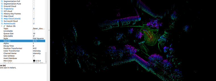

<p dir="auto">之后重新git lego-loam，重新编译，rviz 报错出现<br />
Failed to transform from frame [/camera] to frame [map]<br />
把src中cpp文件/camera改为camera 。重新编译。<br />
不报错，然后add 增加topic  /laser_cloud_surround的pointcloud2<br />
播放bag文件，lego-loam测试下可以,size改变为0.03及以上左右就可以看到点云地图了<br />
<img src="/forum/assets/uploads/files/1783682177503-e99801cb-70b0-4907-a100-1091352aaea1-663a4a2b11c9534ef796ecbaebe6157d-resized.png" alt="e99801cb-70b0-4907-a100-1091352aaea1-663a4a2b11c9534ef796ecbaebe6157d.png" class=" img-fluid img-markdown" /></p>
