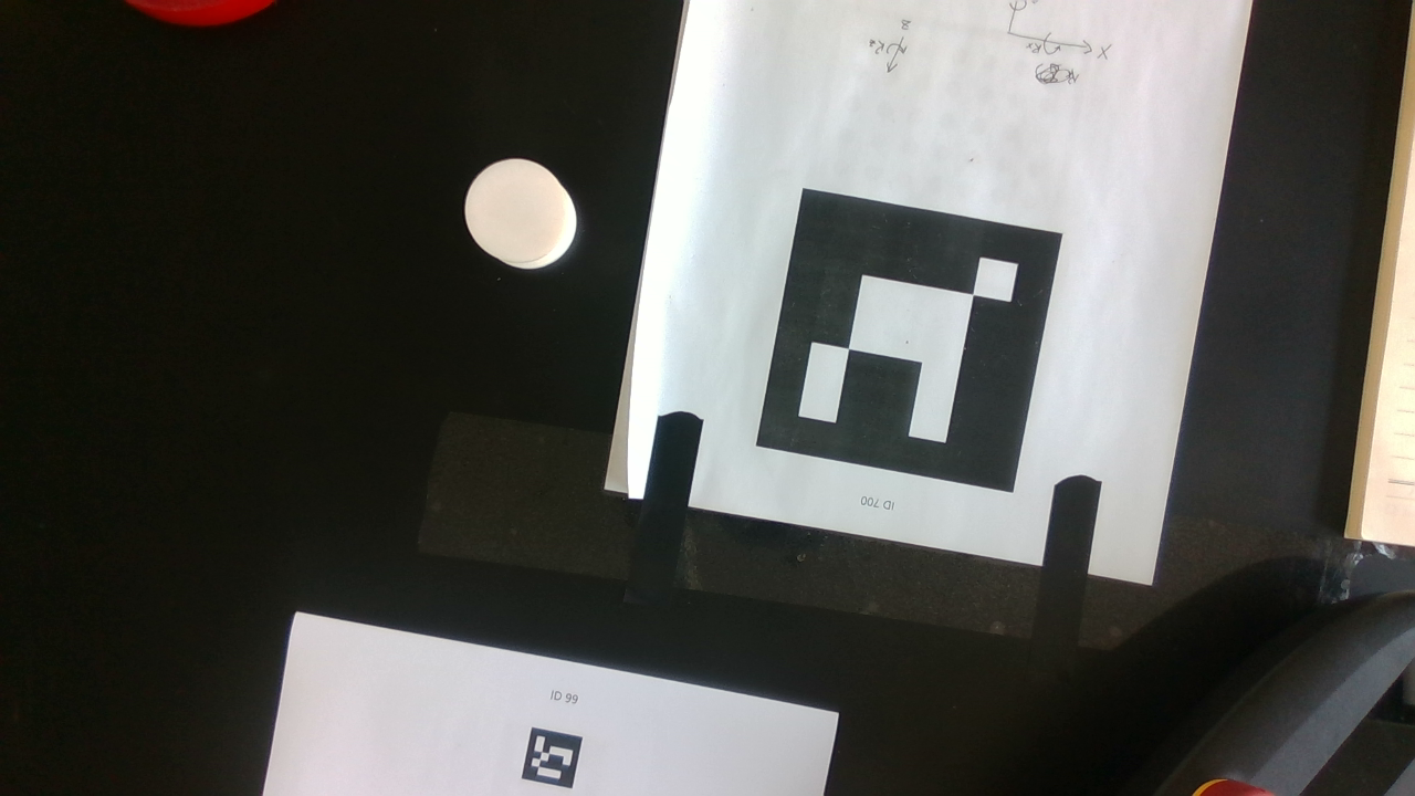

      我使用aruco_ros获取到aruco码的位姿和opencv2.aruco里计算得到的旋转矩阵不一样,不知道哪里出问题了,希望有大佬能帮帮忙看看

      原图

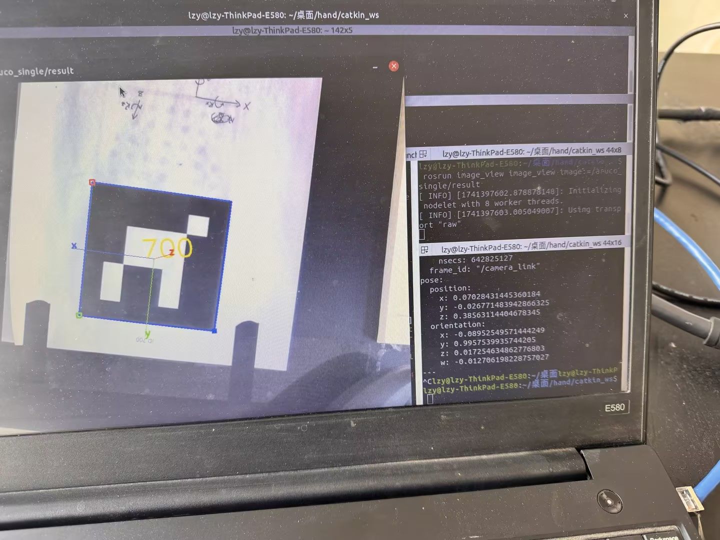

      aruco_ros识别到的数据

          好像我对旋转向量的理解弄错了
          # 转旋转矩阵
           rotation_matrix, _ = cv2.Rodrigues(rvecs[i])
           print("旋转矩阵:\n", rotation_matrix)
           te = tfs.euler.mat2euler(rotation_matrix)
           euler = [math.degrees(e) for e in te]
           print(f"旋转: \n{euler}")
          # 旋转矩阵:
          #  [[-0.98433795 -0.17557593 -0.01587109]
          #  [-0.17612344  0.98333823  0.04501615]
          #  [ 0.0077029   0.04710638 -0.99886018]]
          # 旋转:
          # [177.2999241238412, -0.44134783830292884, -169.8556541200813]
          这么操作后计算的手眼标定结果和ros_aruco一样,但角度还是不太一样
          x= -0.3206890278648447
          y= 0.9433653592637539
          z= 0.01836774839137613
          w= 0.08296367980809832
          q = [w, x, y, z]
          m = tfs.quaternions.quat2mat(q)
          print(m)
          e = tfs.euler.mat2euler(m)
          print(e)
          d = [math.degrees(i) for  i in e]
          print(d)
          # [[-0.78055115 -0.60810155  0.14474945]
          #  [-0.60200613  0.79364235  0.08786608]
          #  [-0.16831079 -0.01855609 -0.98555931]]
          # (-3.1227669003410075, 0.16911576446501436, -2.4846248148191847)
          # [-178.92136379268987, 9.689619552973825, -142.358515562613]
