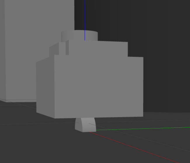

    关于我自制了一个ROS小车的仿真模型,Gazebo车轮陷入地下
    动手学ROS2
    ros2 hamble gazebo 仿真 小车仿真
    1.4k
      1402485721
      求大佬帮我看看
      主要问题
      在Gazebo中的显示为:
      相关代码
      URDF文件如下:

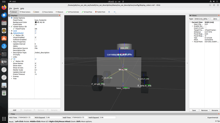

      rviz2的launch文件如下:
      from launch import LaunchDescription
      from launch.substitutions import Command
      from launch_ros.actions import Node
      from ament_index_python.packages import get_package_share_directory
      import os
      def generate_launch_description():
          pkg = get_package_share_directory("ros_car_description")
          xacro_file = os.path.join(pkg, "urdf", "ros_car.urdf.xacro")
          robot_description = {"robot_description": Command(["xacro", " ", xacro_file])}
          rviz_config = os.path.join(pkg, "config", "display_robot.rviz")
          return LaunchDescription(
                  Node(
                      package="robot_state_publisher",
                      executable="robot_state_publisher",
                      parameters=[robot_description],
                      output="screen",

        374200573 0 @1402485721
        @1402485721 gazebo 的kp kd 太小
