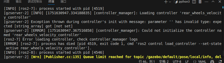

    为什么四轮的添加阿克曼一直报错未初始化
    机器人学
    ros2 阿克曼
    1.6k
      1557105637
      51cfb266-ea72-47a5-b4c5-8f3b4649e5f5-image.png controller_manager:
      ros__parameters:
      update_rate: 100 # Hz
      use_sim_time: true
      fishbot_joint_state_broadcaster:
      type: joint_state_broadcaster/JointStateBroadcaster
      use_sim_time: true
      update_rate: 50
      rear_wheels_velocity_controller:
      type: ackermann_steering_controller/AckermannSteeringController
        # left_wheel: "lbj"  # 后左轮关节名
        # right_wheel: "rbj" # 后右轮关节名
        # left_steering: "lftj"      # 前轮转向关节
        # right_steering: "rftj"
        #front_steering_joints: ["lftj", "rftj"]  # 必须匹配 URDF
        rear_wheel_joints: ["rbj", "lbj"]
        front_wheel_joints: ["rfj", "lfj"]
        wheelbase: 0.63  # 前后轮轴距(米)
        wheel_radius: 0.075
        wheel_separation: 0.88 # 左右轮距(米)
        max_steer_angle: 0.52
        cmd_vel_topic: "/cmd_vel"  # 订阅的cmd_vel话题
        odom_topic: "/odom"        # 发布的里程计话题
        odom_frame_id: odom
        base_frame_id: base_footprint
        pose_covariance_diagonal: [0.001, 0.001, 0.0, 0.0, 0.0, 0.01]
        twist_covariance_diagonal: [0.001, 0.0, 0.0, 0.0, 0.0, 0.01]
        enable_odom_tf: true      # 启用odom到base_link的TF变换
        cmd_vel_timeout: 0.5     # 指令超时时间(秒)
        publish_rate: 50.0        # 发布频率(Hz)
        use_stamped_vel: false    # 不使用时间戳速度指令
        open_loop: true
      # 前轮转向控制器(位置控制)
      fishbot_front_wheels_position_controller:
        type: position_controllers/JointGroupPositionController
      ros__parameters:
      joints:
         ["lftj","rftj"]
      command_interfaces: ["position"]
      state_interfaces: ["position"]
      2 1 条回复 最后回复 回复 引用 0
        2820397587 @1557105637
        @1557105637 解决了么兄弟,我也一样的问题
