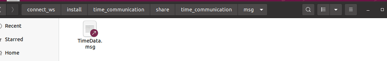

        文件里明明已经生成了.msg,但就是找不到

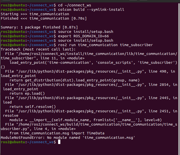

          File "/home/ebox12/connect_ws/install/time_communication/lib/time_communication/time_publisher", line 11, in <module>
          load_entry_point('time-communication', 'console_scripts', 'time_publisher')()
          File "/usr/lib/python3/dist-packages/pkg_resources/init.py", line 490, in load_entry_point
          return get_distribution(dist).load_entry_point(group, name)
          File "/usr/lib/python3/dist-packages/pkg_resources/init.py", line 2854, in load_entry_point
          return ep.load()
          File "/usr/lib/python3/dist-packages/pkg_resources/init.py", line 2445, in load
          return self.resolve()
          File "/usr/lib/python3/dist-packages/pkg_resources/init.py", line 2451, in resolve
          module = import(self.module_name, fromlist=['name'], level=0)
          File "/home/ebox12/connect_ws/build/time_communication/time_communication/time_publisher.py", line 4, in <module>
          from time_communication.msg import TimeData
          ModuleNotFoundError: No module named 'time_communication.msg'

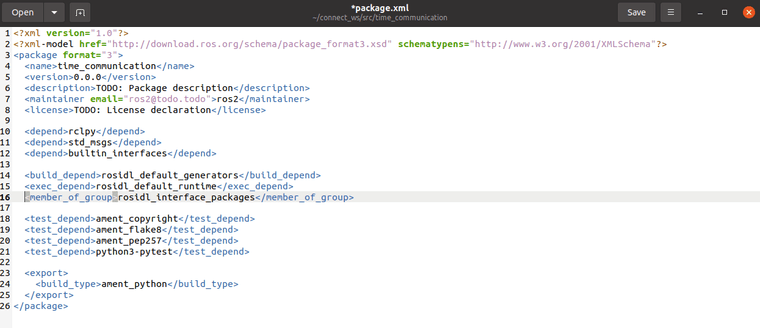

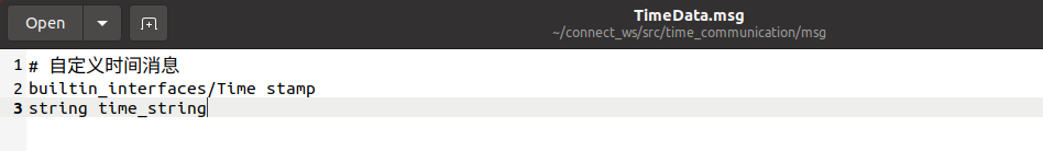

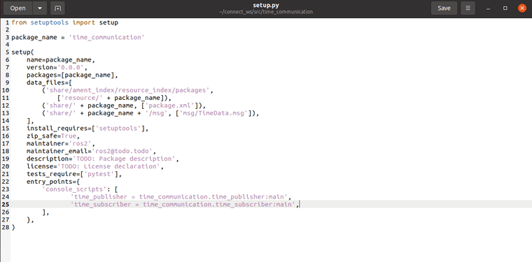

            确实有点奇怪,不过它报的错误是找不到模块time_communication.msg,而不是找不到TimeData.msg,是不是某些细节没搞对导致的?
