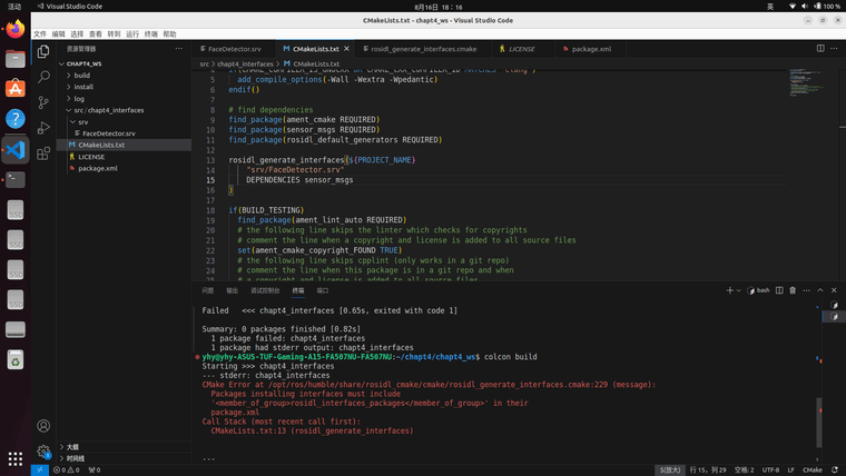

    4.2.1自定义服务接口构建功能包出错
    求助 qt
    2.8k
    • 因
      因却斯丁
      0b69fcd4-5d42-4264-963d-b7e5cac81090-图片.png ```
      code_text
      sensor_msgs/Image image
      int16 number
      float32 use_time
      int32[] top
      int32[] right
      int32[] bottom
      int32[] left

      求解,一步步跟着教程来的,为什么会出现构建失败的情况
      • 因
        因却斯丁
        奇怪的是,我将xml文件中的<member_of_group>rosidl_interface_packages</member_of_group>改为<member_of_group>rosidl_interfaces_packages</member_of_group>后就能构建成功了,我使用的ROS2版本为humble,这就很奇怪

          wsxq2 @因却斯丁
          @因却斯丁 我这边是正常的,/opt/ros/humble/share/rosidl_cmake/cmake/rosidl_generate_interfaces.cmake:229的上下文如下(可以看到__group_name的值是rosidl_interface_packages):
          224       set(_group_name "rosidl_interface_packages")
          225       if(NOT _AMENT_PACKAGE_NAME)
          226         ament_package_xml()
          227       endif()
          228       if(NOT _group_name IN_LIST ${_AMENT_PACKAGE_NAME}_MEMBER_OF_GROUPS)
          229         message(FATAL_ERROR
          230           "Packages installing interfaces must include \
          231           '<member_of_group>${_group_name}</member_of_group>' \
          232           in their package.xml"
          233         )
          你这个确实有点奇怪。是不是没有执行 sudo apt upgrade 之类的导致的?
