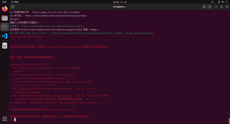

      请输入[]内的数字以选择:3
      Run CMD Task:[wget http://mirror.fishros.com/install/tools/tool_config_rosdep.py -O /tmp/fishinstall/tools/tool_config_rosdep.py --no-check-certificate]
      [-][0.03s] CMD Result:success 80... 已连接。sdep.py
      欢迎使用模板工程,本工具由作者小鱼提供
      Run CMD Task:[sudo apt install python3-pip -y]
      [-][0.50s] CMD Result:success 个软件包未被升级。
      请选择要使用的pip源:
      RUN Choose Task:[请输入括号内的数字]
      请选择pip源:
      [1]:清华源 - https://pypi.tuna.tsinghua.edu.cn/simple
      [2]:阿里云 - https://mirrors.aliyun.com/pypi/simple
      [3]:中国科技大学 - https://pypi.mirrors.ustc.edu.cn/simple
      [4]:华为云 - https://repo.huaweicloud.com/repository/pypi/simple
      0:quit
      请输入[]内的数字以选择:4
      您选择了: https://repo.huaweicloud.com/repository/pypi/simple
      正在使用 https://repo.huaweicloud.com/repository/pypi/simple 安装 rosdepc...
      Run CMD Task:[sudo pip3 install -i https://repo.huaweicloud.com/repository/pypi/simple rosdepc --break-system-packages]
      [-][0.00s] CMD Result:code:2
      检测到程序发生异常退出,请打开:https://fishros.org.cn/forum 携带如下内容进行反馈
      标题:使用一键安装过程中遇到程序崩溃
      Traceback (most recent call last):
        File "/tmp/fishinstall/install.py", line 134, in <module>
          main()
        File "/tmp/fishinstall/install.py", line 123, in main
          run_tool_file(tools[code]['tool'].replace("/","."))
        File "/tmp/fishinstall/tools/base.py", line 1478, in run_tool_file
          if tool.run()==False: return False
        File "/tmp/fishinstall/tools/tool_config_rosdep.py", line 94, in run
          self.install_rosdepc()
        File "/tmp/fishinstall/tools/tool_config_rosdep.py", line 85, in install_rosdepc
          PrintUtils.print_warning("安装失败,尝试使用其他方式安装...")
      AttributeError: type object 'PrintUtils' has no attribute 'print_warning'
      本次运行详细日志文件已保存至 /tmp/fishros_install.log
      检测到本次运行出现失败命令,直接退出按Ctrl+C,按任意键上传日志并退出

        参考一些技术博客,手动修改rosdep2/sources_list.py、rosdistro/init.py、rosdep2/gbpdistro_support.py、rosdep2/rep3.py里面的国外路径安装了
