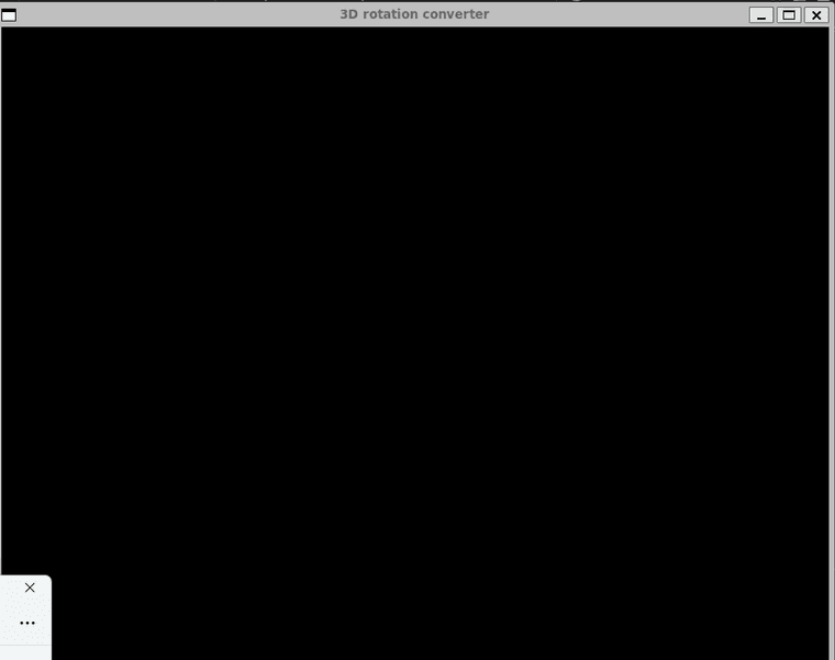

                  请问各位大佬,有遇到过安装了MRPT2,但是打开3d-rotation-converter只能显示一片黑的情况吗?屏幕截图 2025-09-03 153012.png

                      yihao.gdut @himsn
                      @himsn 怎么解决的,我现在也是这样的问题

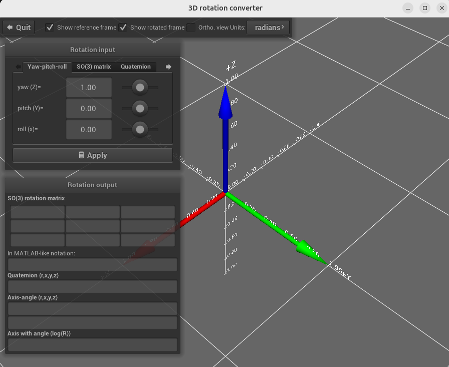

                        直接安装书上说的ros-humble-mrpt2担心版本不匹配,因此自己查询了一些资料,发现需要安装ros-jazzy-mrpt-apps。安装完亲测好用,软件界面跟书上的一样。
                        user@local:~$ sudo apt install ros-jazzy-mrpt-apps
                        Reading package lists... Done
                        Building dependency tree... Done
                        Reading state information... Done
                        The following additional packages will be installed:
                          libamd3 libbtf2 libcamd3 libccolamd3 libcholmod5 libcolamd3 libcxsparse4
                        Setting up ros-jazzy-mrpt-libapps (2.15.5-1noble.20260121.203335) ...
                        Setting up ros-jazzy-mrpt-apps (2.15.5-1noble.20260121.204353) ...
                        Processing triggers for libc-bin (2.39-0ubuntu8.7) ...
                        user@local:~$ 3d-rotation-converter
