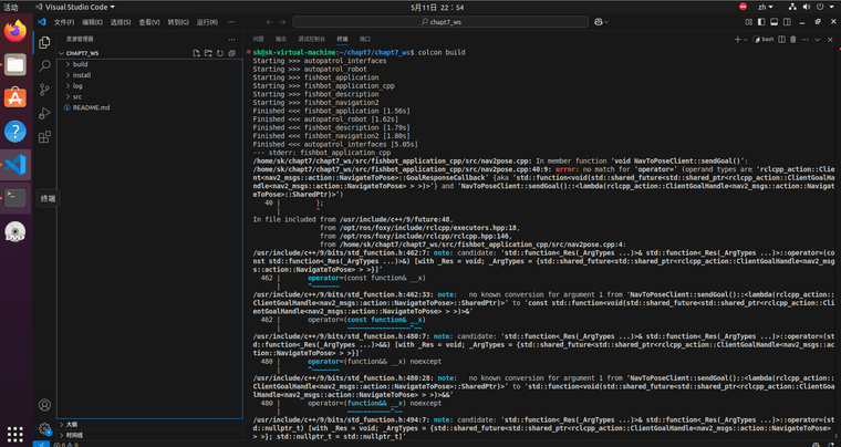

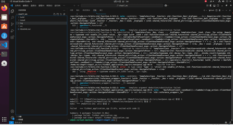

            我是source install时候发现失败,然后发现colcon build的时候就失败了,第一遍用的github上时候还能用,然后学到7.3.2发现没有代价地图,然后改用gitee,然后colcon build时候就报错,返回用github时候依旧报错
            • S
              shawn
              1,版本是foxy版本
              2,终端日志:sk@sk-virtual-machine:~/chapt7/chapt7_ws$ colcon build
              Starting >>> autopatrol_interfaces
              Starting >>> autopatrol_robot
              Starting >>> fishbot_application
              Starting >>> fishbot_application_cpp
              Starting >>> fishbot_description
              Starting >>> fishbot_navigation2
              Finished <<< fishbot_application [1.87s]
              Finished <<< autopatrol_robot [1.90s]
              Finished <<< fishbot_navigation2 [2.17s]
              Finished <<< fishbot_description [2.20s]
              Finished <<< autopatrol_interfaces [7.11s]
              --- stderr: fishbot_application_cpp
              /home/sk/chapt7/chapt7_ws/src/fishbot_application_cpp/src/nav2pose.cpp: In member function ‘void NavToPoseClient::sendGoal()’:
              /home/sk/chapt7/chapt7_ws/src/fishbot_application_cpp/src/nav2pose.cpp:40:9: error: no match for ‘operator=’ (operand types are ‘rclcpp_action::Client<nav2_msgs::action::NavigateToPose>::GoalResponseCallback’ {aka ‘std::function<void(std::shared_future<std::shared_ptr<rclcpp_action::ClientGoalHandle<nav2_msgs::action::NavigateToPose> > >)>’} and ‘NavToPoseClient::sendGoal()::<lambda(rclcpp_action::ClientGoalHandle<nav2_msgs::action::NavigateToPose>::SharedPtr)>’)
              40 | };
              In file included from /usr/include/c++/9/future:48,
              from /opt/ros/foxy/include/rclcpp/executors.hpp:18,
              from /opt/ros/foxy/include/rclcpp/rclcpp.hpp:146,
              from /home/sk/chapt7/chapt7_ws/src/fishbot_application_cpp/src/nav2pose.cpp:4:
              /usr/include/c++/9/bits/std_function.h:462:7: note: candidate: ‘std::function<_Res(_ArgTypes ...)>& std::function<_Res(_ArgTypes ...)>::operator=(const std::function<_Res(_ArgTypes ...)>&) [with _Res = void; _ArgTypes = {std::shared_future<std::shared_ptr<rclcpp_action::ClientGoalHandle<nav2_msgs::action::NavigateToPose> > >}]’
              462 | operator=(const function& __x)
              /usr/include/c++/9/bits/std_function.h:462:33: note: no known conversion for argument 1 from ‘NavToPoseClient::sendGoal()::<lambda(rclcpp_action::ClientGoalHandle<nav2_msgs::action::NavigateToPose>::SharedPtr)>’ to ‘const std::function<void(std::shared_future<std::shared_ptr<rclcpp_action::ClientGoalHandle<nav2_msgs::action::NavigateToPose> > >)>&’
              /usr/include/c++/9/bits/std_function.h:480:7: note: candidate: ‘std::function<_Res(_ArgTypes ...)>& std::function<_Res(_ArgTypes ...)>::operator=(std::function<_Res(_ArgTypes ...)>&&) [with _Res = void; _ArgTypes = {std::shared_future<std::shared_ptr<rclcpp_action::ClientGoalHandle<nav2_msgs::action::NavigateToPose> > >}]’
              480 | operator=(function&& __x) noexcept
              /usr/include/c++/9/bits/std_function.h:480:28: note: no known conversion for argument 1 from ‘NavToPoseClient::sendGoal()::<lambda(rclcpp_action::ClientGoalHandle<nav2_msgs::action::NavigateToPose>::SharedPtr)>’ to ‘std::function<void(std::shared_future<std::shared_ptr<rclcpp_action::ClientGoalHandle<nav2_msgs::action::NavigateToPose> > >)>&&’
              /usr/include/c++/9/bits/std_function.h:494:7: note: candidate: ‘std::function<_Res(_ArgTypes ...)>& std::function<_Res(_ArgTypes ...)>::operator=(std::nullptr_t) [with _Res = void; _ArgTypes = {std::shared_future<std::shared_ptr<rclcpp_action::ClientGoalHandle<nav2_msgs::action::NavigateToPose> > >}; std::nullptr_t = std::nullptr_t]’
              494 | operator=(nullptr_t) noexcept
              /usr/include/c++/9/bits/std_function.h:494:17: note: no known conversion for argument 1 from ‘NavToPoseClient::sendGoal()::<lambda(rclcpp_action::ClientGoalHandle<nav2_msgs::action::NavigateToPose>::SharedPtr)>’ to ‘std::nullptr_t’
              /usr/include/c++/9/bits/std_function.h:523:2: note: candidate: ‘template<class _Functor> std::function<_Res(_ArgTypes ...)>::_Requires<std::function<_Res(_ArgTypes ...)>::_Callable<typename std::decay<_Functor>::type>, std::function<_Res(_ArgTypes ...)>&> std::function<_Res(_ArgTypes ...)>::operator=(_Functor&&) [with _Functor = _Functor; _Res = void; _ArgTypes = {std::shared_future<std::shared_ptr<rclcpp_action::ClientGoalHandle<nav2_msgs::action::NavigateToPose> > >}]’
              523 | operator=(_Functor&& __f)
              /usr/include/c++/9/bits/std_function.h:523:2: note: template argument deduction/substitution failed:
              /usr/include/c++/9/bits/std_function.h: In substitution of ‘template<class _Res, class ... _ArgTypes> template<class _Cond, class _Tp> using _Requires = typename std::enable_if<_Cond::value, _Tp>::type [with _Cond = std::function<void(std::shared_future<std::shared_ptr<rclcpp_action::ClientGoalHandle<nav2_msgs::action::NavigateToPose> > >)>::_Callable<NavToPoseClient::sendGoal()::<lambda(rclcpp_action::ClientGoalHandle<nav2_msgs::action::NavigateToPose>::SharedPtr)>, std::__invoke_result<NavToPoseClient::sendGoal()::<lambda(rclcpp_action::ClientGoalHandle<nav2_msgs::action::NavigateToPose>::SharedPtr)>&, std::shared_future<std::shared_ptr<rclcpp_action::ClientGoalHandle<nav2_msgs::action::NavigateToPose> > > > >; _Tp = std::function<void(std::shared_future<std::shared_ptr<rclcpp_action::ClientGoalHandle<nav2_msgs::action::NavigateToPose> > >)>&; _Res = void; _ArgTypes = {std::shared_future<std::shared_ptr<rclcpp_action::ClientGoalHandle<nav2_msgs::action::NavigateToPose> > >}]’:
              /usr/include/c++/9/bits/std_function.h:523:2: required by substitution of ‘template<class _Functor> std::function<void(std::shared_future<std::shared_ptr<rclcpp_action::ClientGoalHandle<nav2_msgs::action::NavigateToPose> > >)>::_Requires<std::function<void(std::shared_future<std::shared_ptr<rclcpp_action::ClientGoalHandle<nav2_msgs::action::NavigateToPose> > >)>::_Callable<typename std::decay<_Tp>::type, std::__invoke_result<typename std::decay<_Tp>::type&, std::shared_future<std::shared_ptr<rclcpp_action::ClientGoalHandle<nav2_msgs::action::NavigateToPose> > > > >, std::function<void(std::shared_future<std::shared_ptr<rclcpp_action::ClientGoalHandle<nav2_msgs::action::NavigateToPose> > >)>&> std::function<void(std::shared_future<std::shared_ptr<rclcpp_action::ClientGoalHandle<nav2_msgs::action::NavigateToPose> > >)>::operator=<_Functor>(_Functor&&) [with _Functor = NavToPoseClient::sendGoal()::<lambda(rclcpp_action::ClientGoalHandle<nav2_msgs::action::NavigateToPose>::SharedPtr)>]’
              /home/sk/chapt7/chapt7_ws/src/fishbot_application_cpp/src/nav2pose.cpp:40:9: required from here
              /usr/include/c++/9/bits/std_function.h:385:8: error: no type named ‘type’ in ‘struct std::enable_if<false, std::function<void(std::shared_future<std::shared_ptr<rclcpp_action::ClientGoalHandle<nav2_msgs::action::NavigateToPose> > >)>&>’
              385 | using _Requires = typename enable_if<_Cond::value, _Tp>::type;
              /usr/include/c++/9/bits/std_function.h:532:2: note: candidate: ‘template<class _Functor> std::function<_Res(_ArgTypes ...)>& std::function<_Res(_ArgTypes ...)>::operator=(std::reference_wrapper<_Functor>) [with _Functor = _Functor; _Res = void; _ArgTypes = {std::shared_future<std::shared_ptr<rclcpp_action::ClientGoalHandle<nav2_msgs::action::NavigateToPose> > >}]’
              532 | operator=(reference_wrapper<_Functor> __f) noexcept
              /usr/include/c++/9/bits/std_function.h:532:2: note: template argument deduction/substitution failed:
              /home/sk/chapt7/chapt7_ws/src/fishbot_application_cpp/src/nav2pose.cpp:40:9: note: ‘NavToPoseClient::sendGoal()::<lambda(rclcpp_action::ClientGoalHandle<nav2_msgs::action::NavigateToPose>::SharedPtr)>’ is not derived from ‘std::reference_wrapper<_Tp>’
              40 | };
              make[2]: *** [CMakeFiles/nav2pose.dir/build.make:63:CMakeFiles/nav2pose.dir/src/nav2pose.cpp.o] 错误 1
              make[1]: *** [CMakeFiles/Makefile2:78:CMakeFiles/nav2pose.dir/all] 错误 2
              make: *** [Makefile:141:all] 错误 2
              Failed <<< fishbot_application_cpp [7.27s, exited with code 2]
              Summary: 5 packages finished [7.63s]
              1 package failed: fishbot_application_cpp
              1 package had stderr output: fishbot_application_cpp
