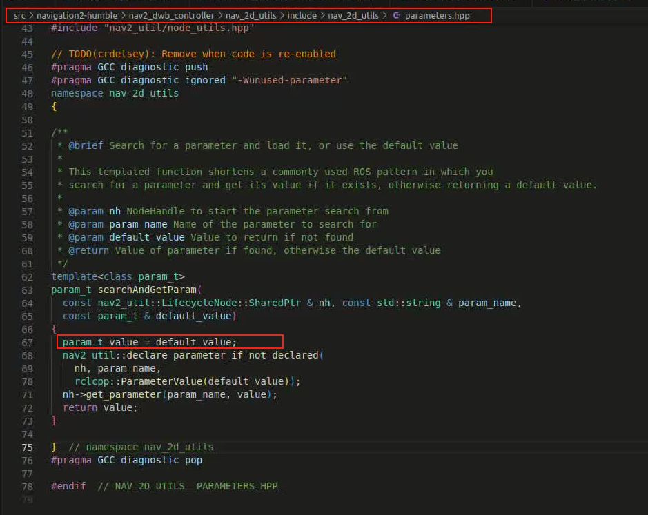

          @luqixuan 你好,我试了将已存在的包忽略掉,不编译它,但是还是会出现报错:
          终端打印如下;
          robot@robot-hp:~/project/test_nav2$ colcon build --packages-ignore nav2_msgs nav2_common nav2_costmap_2d nav2_map_server nav2_core nav2_util nav2_voxel_grid nav2_lifecycle_manager
          Starting >>> nav_2d_msgs
          Starting >>> costmap_queue
          Starting >>> nav2_behavior_tree
          Starting >>> nav2_regulated_pure_pursuit_controller
          Starting >>> nav2_amcl
          Starting >>> nav2_collision_monitor
          Starting >>> nav2_constrained_smoother
          Starting >>> nav2_mppi_controller
          Starting >>> nav2_navfn_planner
          Starting >>> nav2_planner
          Starting >>> nav2_rviz_plugins
          Starting >>> nav2_simple_commander
          Starting >>> nav2_smac_planner
          Starting >>> nav2_theta_star_planner
          Starting >>> nav2_velocity_smoother
          Starting >>> nav2_waypoint_follower
          Finished <<< costmap_queue [0.92s]
          Finished <<< nav2_collision_monitor [0.92s]
          Finished <<< nav2_navfn_planner [0.93s]
          Finished <<< nav2_regulated_pure_pursuit_controller [0.96s]
          Finished <<< nav2_mppi_controller [0.95s]
          Finished <<< nav2_amcl [0.98s]
          Finished <<< nav2_rviz_plugins [0.98s]
          Finished <<< nav2_behavior_tree [1.02s]
          Starting >>> nav2_behaviors
          Starting >>> nav2_bt_navigator
          Finished <<< nav2_velocity_smoother [1.07s]
          Finished <<< nav2_theta_star_planner [1.09s]
          Finished <<< nav2_smac_planner [1.12s]
          Finished <<< nav_2d_msgs [1.19s]
          Starting >>> nav_2d_utils
          Starting >>> dwb_msgs
          Finished <<< nav_2d_utils [0.48s]
          Starting >>> nav2_controller
          Starting >>> nav2_smoother
          Finished <<< nav2_controller [0.61s]
          Starting >>> nav2_rotation_shim_controller
          Starting >>> nav2_graceful_controller
          Finished <<< dwb_msgs [1.47s]
          Starting >>> dwb_core
          Finished <<< dwb_core [0.58s]
          Starting >>> dwb_critics
          Starting >>> dwb_plugins
          Finished <<< nav2_simple_commander [4.31s]
          [Processing: dwb_critics, dwb_plugins, nav2_behaviors, nav2_bt_navigator, nav2_constrained_smoother, nav2_graceful_controller, nav2_planner, nav2_rotation_shim_controller, nav2_smoother, nav2_waypoint_follower]
          --- stderr: dwb_plugins
          In file included from /opt/ros/humble/include/rclcpp/rclcpp/node_interfaces/node_parameters_interface.hpp:28,
          from /opt/ros/humble/include/rclcpp/rclcpp/node.hpp:54,
          from /opt/ros/humble/include/rclcpp/rclcpp/executors/single_threaded_executor.hpp:28,
          from /opt/ros/humble/include/rclcpp/rclcpp/executors.hpp:22,
          from /opt/ros/humble/include/rclcpp/rclcpp/rclcpp.hpp:155,
          from /home/robot/project/test_nav2/src/navigation2/nav2_dwb_controller/dwb_plugins/include/dwb_plugins/standard_traj_generator.hpp:42,
          from /home/robot/project/test_nav2/src/navigation2/nav2_dwb_controller/dwb_plugins/include/dwb_plugins/limited_accel_generator.hpp:41,
          from /home/robot/project/test_nav2/src/navigation2/nav2_dwb_controller/dwb_plugins/src/limited_accel_generator.cpp:35:
          In constructor ‘rclcpp::Parameter::Parameter(const std::string&, ValueTypeT) [with ValueTypeT = double]’,
          inlined from ‘bool rclcpp_lifecycle::LifecycleNode::get_parameter(const std::string&, ParameterT&) const [with ParameterT = double]’ at /opt/ros/humble/include/rclcpp_lifecycle/rclcpp_lifecycle/lifecycle_node_impl.hpp:256:21,
          inlined from ‘param_t nav_2d_utils::searchAndGetParam(const rclcpp_lifecycle::LifecycleNode::SharedPtr&, const std::string&, const param_t&) [with param_t = double]’ at /home/robot/project/test_nav2/install/nav_2d_utils/include/nav_2d_utils/parameters.hpp:71:20:
          /opt/ros/humble/include/rclcpp/rclcpp/parameter.hpp:70:21: error: ‘value’ may be used uninitialized [-Werror=maybe-uninitialized]
          70 | : Parameter(name, ParameterValue(value))
          In file included from /home/robot/project/test_nav2/src/navigation2/nav2_dwb_controller/dwb_plugins/src/limited_accel_generator.cpp:39:
          /home/robot/project/test_nav2/install/nav_2d_utils/include/nav_2d_utils/parameters.hpp: In function ‘param_t nav_2d_utils::searchAndGetParam(const rclcpp_lifecycle::LifecycleNode::SharedPtr&, const std::string&, const param_t&) [with param_t = double]’:
          /home/robot/project/test_nav2/install/nav_2d_utils/include/nav_2d_utils/parameters.hpp:67:11: note: ‘value’ was declared here
          67 | param_t value;
          cc1plus: all warnings being treated as errors

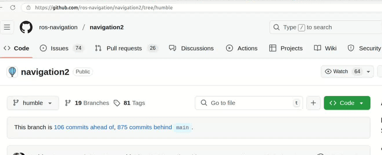

              @小鱼 鱼哥,我的系统是ubuntu22.04, nav2的源码版本是
              应该没有问题吧?

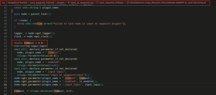

                1. 文件:navigation2-humble/nav2_waypoint_follower/plugins/input_at_waypoint.cpp
                  double timeout ; 改为double timeout = 0.0;

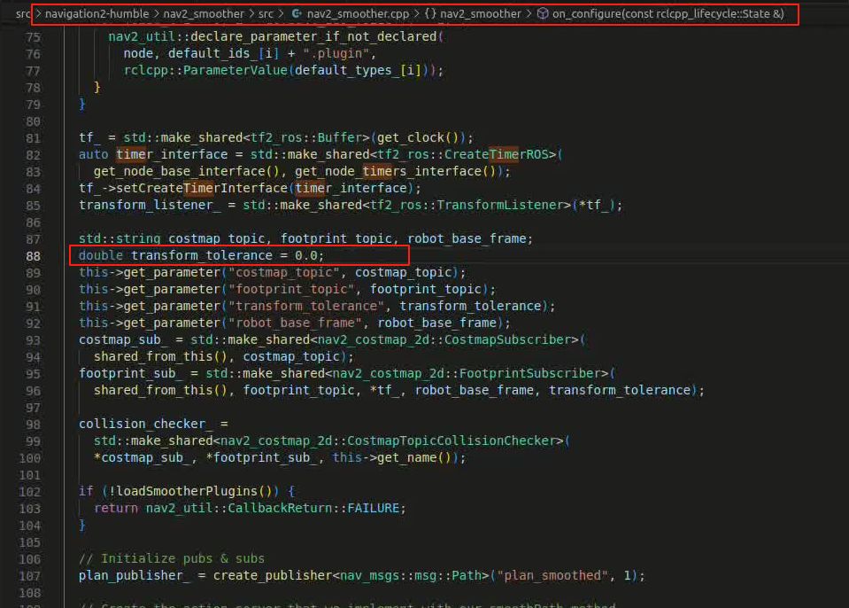

                2.文件:navigation2-humble/nav2_smoother/src/nav2_smoother.cpp
                double transform_tolerance; 改为double transform_tolerance = 0.0;

                3.文件 navigation2-humble/nav2_dwb_controller/nav_2d_utils/include/nav_2d_utils/parameters.hpp
                param_t value ; 改为param_t value = default_value;

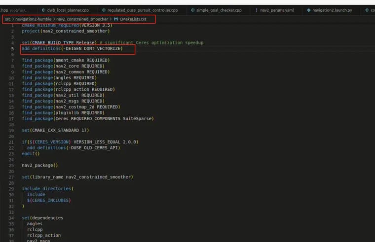

                6.文件navigation2-humble/nav2_constrained_smoother/CmakeLists.txt
                添加 add_definitions(-DEIGEN_DONT_VECTORIZE)
