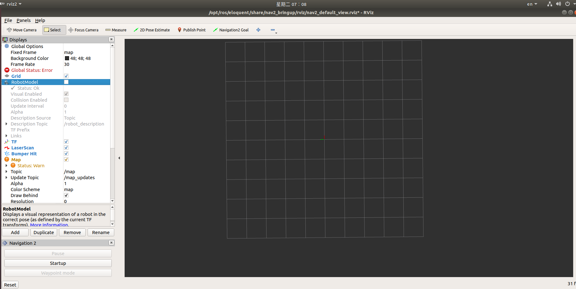

      根据《动手学ros2》进行fishbot的nav2导航仿真,在执行程序:
      ros2 launch fishbot_navigation2 navigation2.launch.py
      时终端出现以下错误:
      [bt_navigator-7] [ERROR] []: Caught exception in callback for transition 10
      [bt_navigator-7] [ERROR] []: Original error: Could not load library: /home/outerman1/fishbot_ws/install/nav2_behavior_tree/lib/libnav2_compute_path_to_pose_action_bt_node.so: undefined symbol: _ZTIN2BT14CoroActionNodeE
      [bt_navigator-7] [WARN] []: Error occurred while doing error handling.
      [bt_navigator-7] [FATAL] [bt_navigator]: Lifecycle node entered error state
      [lifecycle_manager-1] [ERROR] [lifecycle_manager]: Failed to change state for node: bt_navigator
      [lifecycle_manager-1] [ERROR] [lifecycle_manager]: Failed to bring up nodes: aborting bringup
      rviz2中显示的内容如下:
      对照github上鱼哥发的源码,发现代码部分不存在问题
      当前使用的是ros2-eloquent版本,ubuntu是18.04,源码安装nav2和apt安装nav2都尝试过,均出现以上错误。
      卡了好几天,希望大佬帮助一下,感谢!!

          小鱼 技术大佬 @3568485143
          @3568485143 换个版本ros
