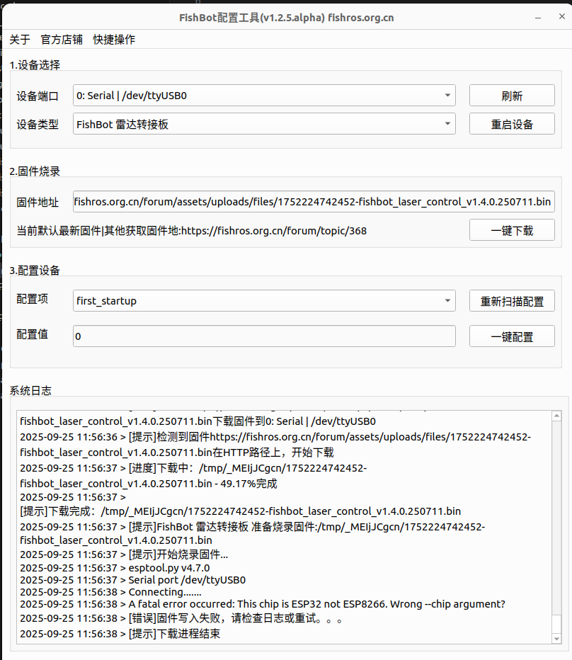

      ad4f5a9c-17a6-4b75-9cb4-d73eec606053-image.png 不管下载哪个版本固件都显示这个错误,是什么原因

        @2251581333 在 [FishBot教程] 9.0.5. 雷达固件烧录及配置 中说:
        烧录的时候说芯片不对,怎么解决呀鱼哥
        2023-04-08 07:37:37 > 准备从https://www.fishros.org.cn/forum/assets/uploads/files/1673413115955-fishbot_laser_control_v1.0.0.230111.bin下载固件到/dev/ttyUSB0对应芯片为esp8266
        2023-04-08 07:37:37 > 准备从网址下载固件...
        2023-04-08 07:37:39 >
        2023-04-08 07:37:39 > --2023-04-08 07:37:36-- https://www.fishros.org.cn/forum/assets/uploads/files/1673413115955-fishbot_laser_control_v1.0.0.230111.bin
        2023-04-08 07:37:39 > Resolving www.fishros.org.cn (www.fishros.org.cn)... 124.222.2.110
        2023-04-08 07:37:39 > Connecting to www.fishros.org.cn (www.fishros.org.cn)|124.222.2.110|:443... connected.
        2023-04-08 07:37:39 > HTTP request sent, awaiting response... 200 OK
        2023-04-08 07:37:39 > Length: 532320 (520K) [application/octet-stream]
        2023-04-08 07:37:39 > Saving to: ‘esp8266.bin’
        2023-04-08 07:37:39 > 固件下载完成!
        2023-04-08 07:37:39 > 开始烧录固件...
        2023-04-08 07:37:39 > esptool.py v4.4
        2023-04-08 07:37:39 > Serial port /dev/ttyUSB0
        2023-04-08 07:37:39 > Connecting....
        2023-04-08 07:37:39 > A fatal error occurred: This chip is ESP32 not ESP8266. Wrong --chip argument?
        2023-04-08 07:37:39 > [错误]固件写入失败,请检查日志或重试。。。
