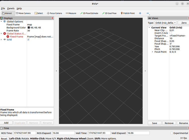

            根据视频教程9.5.5完成机器人建图时,rviz2插件无法加载出map地图,

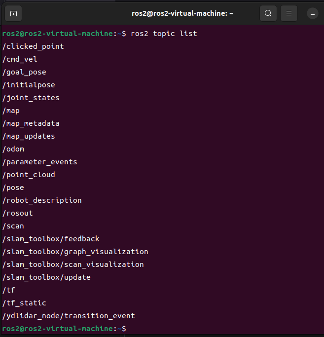

            查看话题如下:
            ros@ros-virtual-machine:~$ ros2 topic list
            /clicked_point
            /cmd_vel
            /goal_pose
            /initialpose
            /joint_states
            /map
            /map_metadata
            /map_updates
            /odom
            /parameter_events
            /point_cloud
            /pose
            /robot_description
            /rosout
            /scan
            /slam_toolbox/feedback
            /slam_toolbox/graph_visualization
            /slam_toolbox/scan_visualization
            /slam_toolbox/update
            /tf
            /tf_static
            /ydlidar_node/transition_event
            @小鱼 什么原因导致的,怎么排查此问题?

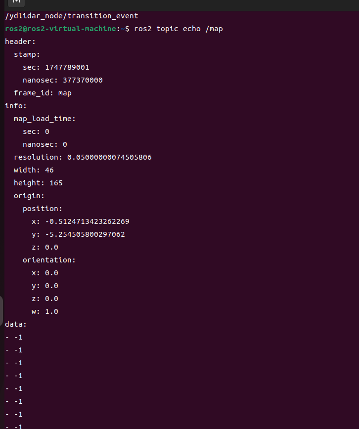

                @2889839823运行rviz2加载地图后,地图不会实时刷新,报错如下
                ros@ros-virtual-machine:~/demo01_ws/fishros_ws$ rviz2
                [INFO] [1747643790.580932382] [rviz2]: Stereo is NOT SUPPORTED
                [INFO] [1747643790.581076461] [rviz2]: OpenGl version: 4.3 (GLSL 4.3)
                [INFO] [1747643790.617443151] [rviz2]: Stereo is NOT SUPPORTED
                [INFO] [1747643799.501060541] [rviz2]: Trying to create a map of size 209 x 205 using 1 swatches
                [ERROR] [1747643799.533153654] [rviz2]: Vertex Program:rviz/glsl120/indexed_8bit_image.vert Fragment Program:rviz/glsl120/indexed_8bit_image.frag GLSL link result :
                active samplers with a different type refer to the same texture image unit
                [INFO] [1747643819.500981429] [rviz2]: Trying to create a map of size 209 x 205 using 1 swatches
                [INFO] [1747643824.525077935] [rviz2]: Trying to create a map of size 209 x 205 using 1 swatches
                [INFO] [1747643829.516767314] [rviz2]: Trying to create a map of size 209 x 205 using 1 swatches
                [INFO] [1747643834.508103811] [rviz2]: Trying to create a map of size 209 x 205 using 1 swatches

                    后知后觉的后知后觉 @luqixuan
                    @luqixuan e09c8683-15ce-40f4-b263-1c96f3b61947-图片.png 094dae82-2609-44a6-a00a-528a40695155-图片.png e3cb9147-46ca-4933-b79b-949ea9d70e46-图片.png
                    L 1 条回复 最后回复 回复 引用 0
                      luqixuan 年度VIP @2889839823
                      @2889839823 大概地图是正常的,显示不太行
                      2 1 条回复 最后回复 回复 引用 0
                        后知后觉的后知后觉 @luqixuan
                        @luqixuan 重新安装系统也还是有这个问题,虚拟机重新安装
