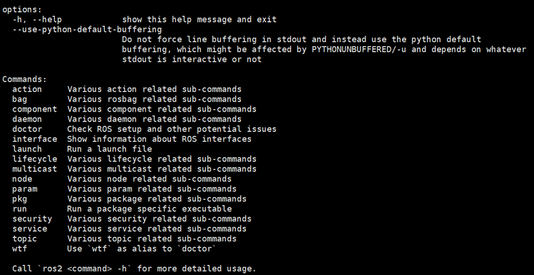

                          1357054725 @小伊
