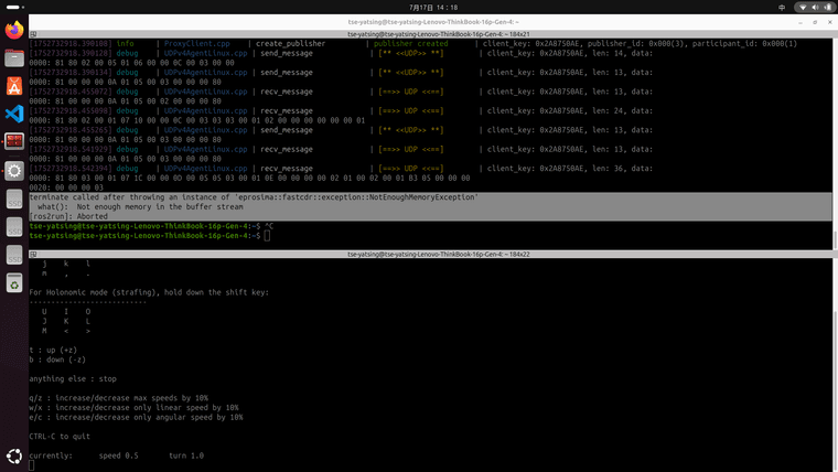

                  小鱼您好,我在运行
                  sudo docker run -it --rm -v /dev:/dev -v /dev/shm:/dev/shm --privileged --net=host microros/micro-ros-agent:$ROS_DISTRO udp4 --port 8888 -v6
                  指令时,一旦我用新的终端窗口跑指令,原本的窗口就会出现以下报错
                  terminate called after throwing an instance of 'eprosima::fastcdr::exception::NotEnoughMemoryException'
                    what():  Not enough memory in the buffer stream
                  [ros2run]: Aborted
                  请求小鱼帮一下解决问题
                      您好,我在笔记本的Ubuntu 24.04.1 LTS双系统上运行9.0.4,但每次开新的终端跑键盘,原本接收数据的终端就会内存泄漏。麻烦小鱼或其他大佬帮忙看看问题回复,在此非常感谢!
                      • 小螃蟹小
                        小螃蟹 @小鱼
                        @小鱼
                        Ubuntu 24.04.1 LTS
                        开终端
                        docker run -it --rm -v /dev:/dev -v /dev/shm:/dev/shm --privileged --net=host registry.cn-hangzhou.aliyuncs.com/fishros/micro-ros-agent:humble udp4 --port 8888 -v6
                        开新终端
                        ros2 run teleop_twist_keyboard teleop_twist_keyboard
                        原终端
                        [1752732918.127213] info     | ProxyClient.cpp    | create_topic             | topic created          | client_key: 0x2A8750AE, topic_id: 0x000(2), participant_id: 0x000(1)
                        [1752732918.127246] debug    | UDPv4AgentLinux.cpp | send_message             | [** <<UDP>> **]        | client_key: 0x2A8750AE, len: 14, data:
                        0000: 81 80 01 00 05 01 06 00 00 0B 00 02 00 00
                        [1752732918.127253] debug    | UDPv4AgentLinux.cpp | send_message             | [** <<UDP>> **]        | client_key: 0x2A8750AE, len: 13, data:
                        0000: 81 00 00 00 0A 01 05 00 02 00 00 00 80
                        [1752732918.164447] debug    | UDPv4AgentLinux.cpp | send_message             | [** <<UDP>> **]        | client_key: 0x2A8750AE, len: 13, data:
                        0000: 81 00 00 00 0B 01 05 00 01 00 01 00 80
                        [1752732918.236313] debug    | UDPv4AgentLinux.cpp | recv_message             | [==>> UDP <<==]        | client_key: 0x2A8750AE, len: 13, data:
                        [1752732918.236517] debug    | UDPv4AgentLinux.cpp | send_message             | [** <<UDP>> **]        | client_key: 0x2A8750AE, len: 13, data:
                        [1752732918.364735] debug    | UDPv4AgentLinux.cpp | send_message             | [** <<UDP>> **]        | client_key: 0x2A8750AE, len: 13, data:
                        [1752732918.370782] debug    | UDPv4AgentLinux.cpp | recv_message             | [==>> UDP <<==]        | client_key: 0x2A8750AE, len: 13, data:
                        [1752732918.389860] debug    | UDPv4AgentLinux.cpp | recv_message             | [==>> UDP <<==]        | client_key: 0x2A8750AE, len: 24, data:
                        0000: 81 80 02 00 01 07 10 00 00 0C 00 03 03 03 00 01 02 00 00 00 00 00 00 01
                        [1752732918.389890] debug    | UDPv4AgentLinux.cpp | recv_message             | [==>> UDP <<==]        | client_key: 0x2A8750AE, len: 13, data:
                        [1752732918.389899] debug    | UDPv4AgentLinux.cpp | recv_message             | [==>> UDP <<==]        | client_key: 0x2A8750AE, len: 13, data:
                        0000: 81 00 00 00 0B 01 05 00 02 00 02 00 80
                        [1752732918.390052] debug    | UDPv4AgentLinux.cpp | send_message             | [** <<UDP>> **]        | client_key: 0x2A8750AE, len: 13, data:
                        0000: 81 00 00 00 0A 01 05 00 02 00 00 01 80
                        [1752732918.390108] info     | ProxyClient.cpp    | create_publisher         | publisher created      | client_key: 0x2A8750AE, publisher_id: 0x000(3), participant_id: 0x000(1)
                        [1752732918.390128] debug    | UDPv4AgentLinux.cpp | send_message             | [** <<UDP>> **]        | client_key: 0x2A8750AE, len: 14, data:
                        0000: 81 80 02 00 05 01 06 00 00 0C 00 03 00 00
                        [1752732918.390134] debug    | UDPv4AgentLinux.cpp | send_message             | [** <<UDP>> **]        | client_key: 0x2A8750AE, len: 13, data:
                        0000: 81 00 00 00 0A 01 05 00 03 00 00 00 80
                        [1752732918.455072] debug    | UDPv4AgentLinux.cpp | recv_message             | [==>> UDP <<==]        | client_key: 0x2A8750AE, len: 13, data:
                        [1752732918.455098] debug    | UDPv4AgentLinux.cpp | recv_message             | [==>> UDP <<==]        | client_key: 0x2A8750AE, len: 24, data:
                        [1752732918.455265] debug    | UDPv4AgentLinux.cpp | send_message             | [** <<UDP>> **]        | client_key: 0x2A8750AE, len: 13, data:
                        [1752732918.541929] debug    | UDPv4AgentLinux.cpp | recv_message             | [==>> UDP <<==]        | client_key: 0x2A8750AE, len: 13, data:
                        [1752732918.542394] debug    | UDPv4AgentLinux.cpp | recv_message             | [==>> UDP <<==]        | client_key: 0x2A8750AE, len: 36, data:
                        0000: 81 80 03 00 01 07 1C 00 00 0D 00 05 05 03 00 01 0E 00 00 00 00 02 01 00 02 00 01 B3 05 00 00 00
                        0020: 00 00 00 03
                        [ros2run]: Aborted
